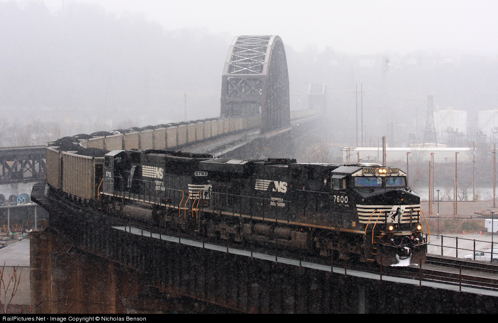

In Pittsburgh PA, you will find numerous curved railroad bridges. They are are everywhere. One of the more famous ones is the one below. It has approaches from two sides curving in towards the main bridge. But what is interesting is that the curved part of the bridge are actually straight sections cut at an angle to create the elongated curve. This could easily be duplicated on your layout but using short straight bridges and angling their ends to create the curve. Also note, this is a massive double line bridge! You can see the other curved section going off on the left.
The photos is from RailPictures.net"

16 years 6 months ago #7993 by bambuko
Replied by bambuko on topic Re:Need help in building a curved bridge
Rob, see: RailPictures.net Photo Usage Policy
I suggest you edit out hotlinked picture and leave just the link ...
Chris
16 years 6 months ago - 16 years 6 months ago #7994 by ztrack
Replied by ztrack on topic Re:Need help in building a curved bridge
Chris,
Good point in the Railpictures user policy. I do give them credit when I post photos from their pages. I think it is important to keep the images in-situ with conversation, which is why I also give them full credit.
Rob
