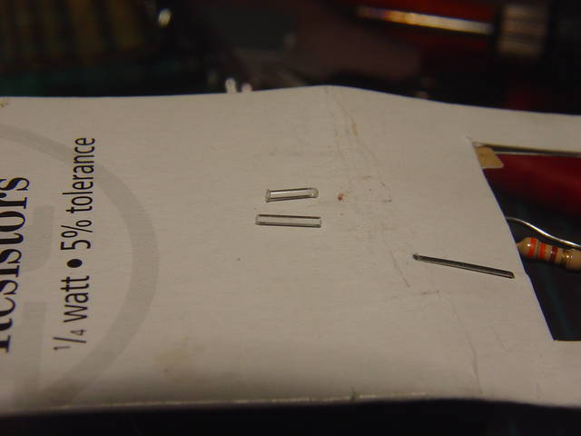

17 years 8 months ago #2666 by shamoo737
Replied by shamoo737 on topic Re:AZL Loco
Elf, this is the fiber optics I used. After cutting it, I use a solder iron to melt the tip, so that it has a smooth lens.
17 years 8 months ago - 17 years 8 months ago #2667 by shamoo737
17 years 8 months ago #2669 by eit27
Replied by eit27 on topic Re:AZL Loco
Many Thanks. This is a major improvement.

Dom, the AZL Leds are not as bright. I been meanig to switch out one the leds to see if it makes a difference. I think it also helps if you installed fiber optics. If you really want it bright, instal a smd right behind the fiber optic.
