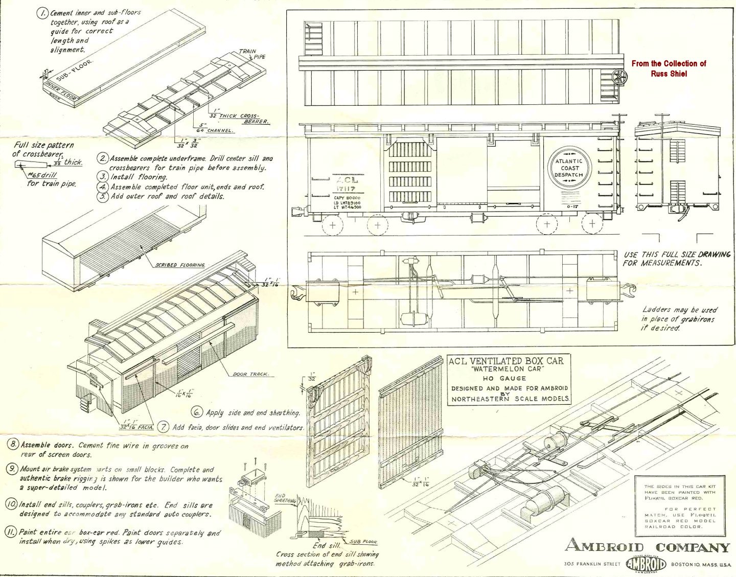

I wonder how hard this would be to make. Once could probably modify an MTL boxcar. Either photo etched, laser, or 3d printing parts. Again the white decals would be the hardest part.

What era are these cars? What style of trucks should be used?

That looks like a ventilated boxcar. I have one in On30.

www.richyodermodels.com/acl_history.htm
From the 20s but you seen them hauling watermelons from down south up to the 60s. Look up ventilated boxcars or watermelon cars and you will find quite a few pictures. In one of my reference books there was some being puled by the road I model. Trucks would depend on when you are modeling it I suppose.

There are actually 2 doors on each side, a ventilated door on the inside and a solid door on the outside. The vents on the ends could also be open or closed. It would be interesting to see in Z scale.

I guess there are different types. The way I am seeing the cars, you have 2 doors on each side on the outside, both are one the same rail. You either slide the solid door from one side over the opening, or the ventilated door from the other side over the opening, or as I have read, use both together so car is partially ventilated.
hawkinsrails.net/mainlines/scl/scl.htm
www.richyodermodels.com/acl_reserve.htm
All the pictures I see show the 2 different kind of doors one on each side of the car, in a kind of recessed part that is 3 doors wide.
