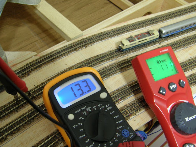

Hi Simon. First, make sure you measure the DCC voltage with a True RMS voltmeter, not an ordinary "AC" voltmeter. The DCC signal is a squarewave, changing between 8 kilohertz and 10 kilohertz. An ordinary meter can be 2-5 volts higher or lower, depending on the internals or digital or analog display.
More info: members.optusnet.com.au/nswmn2/DCC_Meters.htm

I've been using Lenz at 10v for several years. No problems that I am aware of. If you want to increase the voltage, it is easy on the Lenz as it is just a software program change - much like programming a decoder. I use a TONY'S Rampmeter which is specifically designed for DCC. All the Marklin engines draw more amperage than the Micro Trains. OTOH with about about 10 engines sitting on the track I see very little amperage [expected]. Running up to three to four [some mued engines] I never see amperage over 1 amp except at startup.
