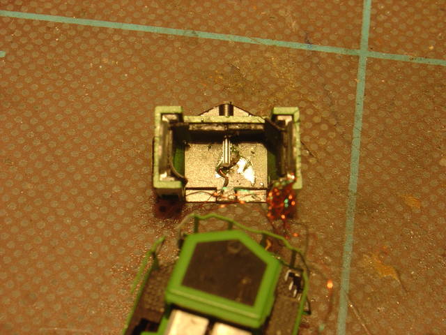

On the Digitrax decoders the LED is mounted on the board. What is the best method of directing the light from the rear LED into the light housing? Right now it just lights up the shell and no light gets to the rear number boards. I have put black tape on the inside of the side and that has helped but still no light to the number boards.
17 years 6 months ago #4512 by SJ-BAZ-man
Replied by SJ-BAZ-man on topic Re:Decoders Digitrax vs TCS
For the front headlights, you can get plastic fiber optic to put in the hole. Just the shortest piece (like 1/8" or 3mm) makes a HUGE difference in gathering up inside light. But for the number boards, it depends on the boards. Most are all black with only the numbers clear. Some are clear with the black numbers. You will have to either change the SMD (surface mount device) LED on the Digitrax board to a conventional T1 or so LED (like the original board, only put the LED on the correct side of the board !). One other option is to glue 2 fiber optics to the back of the number boards and run them to the LED, not an easy task.
But remember, prototype boards are not all that bright. Looking at them from the side will also greatly reduce the apparent light.
17 years 6 months ago #4517 by eit27
Replied by eit27 on topic Re:Decoders Digitrax vs TCS
Jeff,
Thanks for your help. This makes complete sense. Thanks once again.
17 years 6 months ago #4525 by shamoo737
Replied by shamoo737 on topic Re:Decoders Digitrax vs TCS
This is how you do it. Remember to melt the ends after cutting the fiber optics. It makes a big difference.
17 years 6 months ago #4527 by eit27
You know what they say, a pictures worth a thousand words. Thanks for the picture.
