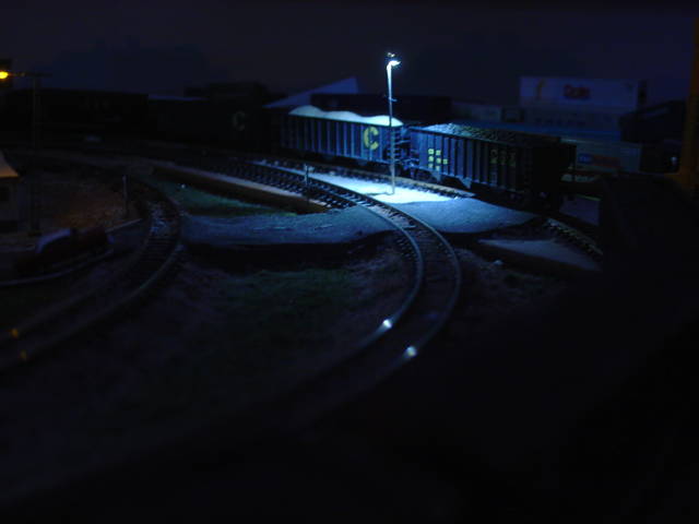

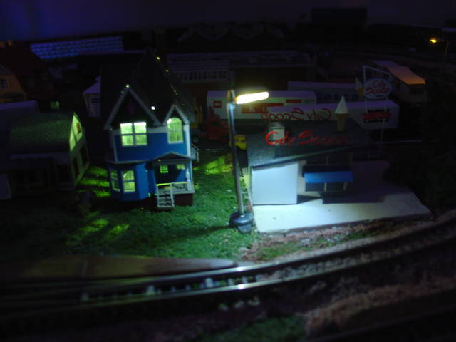

Kelly, I get home late, so my layout look too dark. That's when I started to light up my layout. I think it looks pretty cool with lights. I have street lamps, lighted buildings, and lighted signals. I also have engines with ditch lights, and cars with FREDS.

www.trainboard.com/grapevine/showthread.php?t=96168
The cheapest way is to make your own using smds, and brass tubing. Here is a link to where you can find all the supplies. If you do a search, you can find smds cheaper.
www.ngineering.com/Z_shade_photos.htm

The picture on the ngineering wedsite were very informative. Thanks for the link. Do you happen to know what lengths to cut the tubing to get the proper height? Thanks.
17 years 9 months ago #2165 by shamoo737
Replied by shamoo737 on topic Re:Economical Lighting
I usually cut the about a inch or inch and a half. For warehouses, set it a little higher. They need additional clearance for truck.
