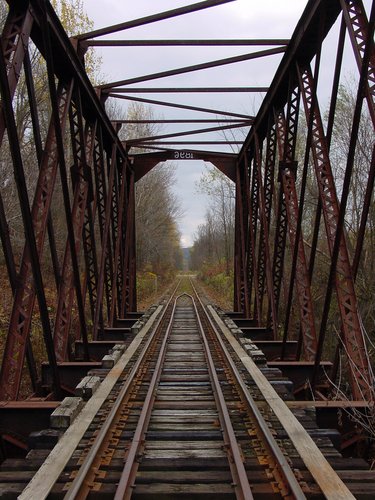

Guardrails on real bridges are sometimes a lighter rail, and sometimes the same rail (usually the latter for heavy Class I mainlines).
Here are lighter guardrails:
www.johnweeks.com/bridges/rrpics/carver01.jpg
www.photographyblogger.net/wp-content/uploads/2009/05/railroad-tracks5.jpg
www.cis.edu.pk/chinioti/Rail-Road-Bridge-In-Side.jpg
www.planetware.com/i/photo/cooperstown-ny154.jpg
rookery2.viary.com/storagev12/757500/757675_b626_625x1000.jpg
And here they are the same weight:
www.whitecountyar.org/JudsoniaRailroadBridge.jpg
www.purswell.com/Rail-Road-Bridge-optz.jpg
www.historicwoolenmills.org/blogimg/002-1260-0010_railroad_brid.jpg
www.lauraleighphoto.com/blog/wp-content/uploads/2009/04/rr3.jpg
(Note that sometimes rail of the same weight looks lighter next to the running rails, but this is an illusion created by the fact that the guardrails have no tie plates, and so they'll sit lower.)
And some don't have any:
gallery.usgs.gov/images/05_01_2009/kOFr37Uhh0_05_01_2009/medium/RG0027.jpg
www.historicbridges.org/other/imlayrr1/IMG_0225.JPG
cdn.wn.com/o25/ph//2009/02/13/c5d79d018f6b42db51a7400307088cda-grande.jpg
One nice aspect of using lighter guardrails is that you can paint them, and the paint is less likely to be removed when cleaning the running rails.

Wonderful pictures David. Can I simple use the rails from another piece of track to make guard rails? I assume I have to bend the ends towards the middle and file the ends on a downward slant. What I don't know is the proper spacing from the existing rails. I assume CA glue would hold them in place. Any feedback would be appreciated. Thanks.
17 years 4 months ago - 17 years 4 months ago #5233 by David K. Smith
Replied by David K. Smith on topic Re:Micronart's girder bridge
I was able to reduce waste by using the rails from the piece of flex I stole the extra ties from. I'm not sure there is a "proper" spacing; I suspect it was dictated by railroads on an individual basis, since the spacing varies--check out the prototype images in my prior post.
Guardrail end treatment varies as well. Some railroads just angle them in, with the ends nearly touching or, in some cases, bent downward and bolted together. Bigger railroads use a cast iron part that attaches to the guardrail ends and is bolted or spiked to the ties, and forms a rounded V-shape.
CA works OK, but because the ties are engineering plastic (like Delrin), the bond is not rock-solid. So, for best results, the guard rails must be as straight as possible before bonding in place. Apply a thin bead of CA to the bottom of the rail and carefully drop into position. After the CA fully cures, paint the rails and ties; this will also hide any visible excess CA.
